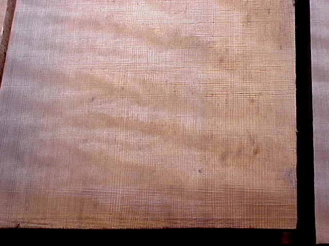

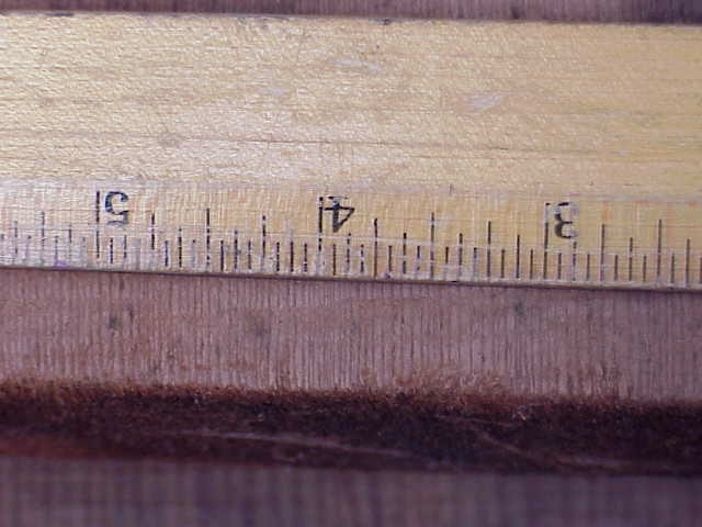

Hi everyone,
As some of you know, I'm trying to start a small internet Tonewood business, and I've just come upon a source for some highly figured (see pictures) salvaged, first growth old redwood. These logs had been sitting at the bottom of a mineral-rich river for more than 100 years and are now stable and dry.
My questions are, has anyone sold these type of tops? Are they considered a high end ticket? Do they sell well? Is the sound quality good? I know that Dennis Scannell of True North Guitars uses this type of wood and raves about redwood tops. Finally, is it worth a $500-$600 investment for 2 slabs that measure 1" x 20" in width x 6.5' in length?
Any and all imput would be greatly appreciated.

looks like some nice curl in them
PostPosted: Tue Sep 13, 2005 6:07 am
It was my understanding that Dennis Scannell was using LS redwood. Certainly that commands a premium.
Doing a little rough back of the envelope thinking I bet you could get at least 12 1 piece tops for guitars and 8 1 piece uke tops.
If you got $50 each for the guitar tops that would be break even and the uke tops would be pure profit. I suspect that you could make a little money on this if the wood is all usable. And if you saw carefully you might even be able to get a better yeild.

It's possible that you could end up with as few as 15 tops from a 6-foot 1x20. That could mean your cost for raw material (not counting labor to resaw the tops) would be $40 for each top. In terms of potential income to be made by reselling, this seems to me to be very expensive lumber unless you know for a fact that the wood is incredible tone-wise and can be sold as master-grade tops.
Ask some of the guys here that resaw softwoods if you can expect to get 4 slices or just 3 from 4/4 lumber.

plus with the curl in this redwood it all may be totally unusable for much
other than drop tops on electrics. With curly redwood some is great and
some the curl totally kills the structural integrity of the wood, and the
length wise stiffness is horrible. I have about 20 curly redwood tops in
the shop that are just this way. Look great but the length wise stiffness is
horrid. And Then I have about 10 sets that are fantastic.
I'd say that sounds expensive for that wood, bu you could probably break
even, or make a small amount of money on it... no where near as much as
the amount of time it would take sawing, sanding, and prepping.
